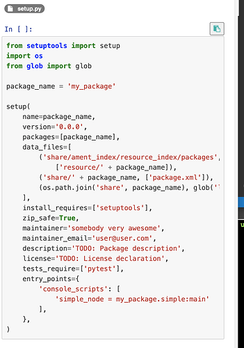

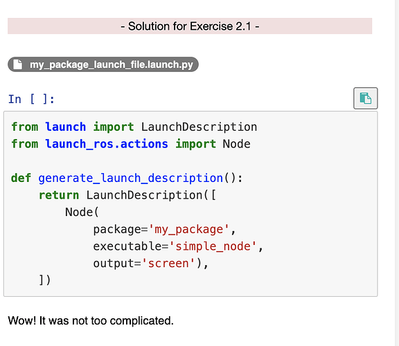

In the ROS2 in 5 days section 2 Basic Concepts, simple.py is create as python script but simple_node is used as the executable.
What is the executable in Launch file and setup.py actually?

Oh I figure it out…
We add an executable to the entry_points, and map the executable to the script and the main function.
Then in the launch file, <executable_name> refers to the <executable_name> of the entry point defined in setup.py to specify which script to run.
