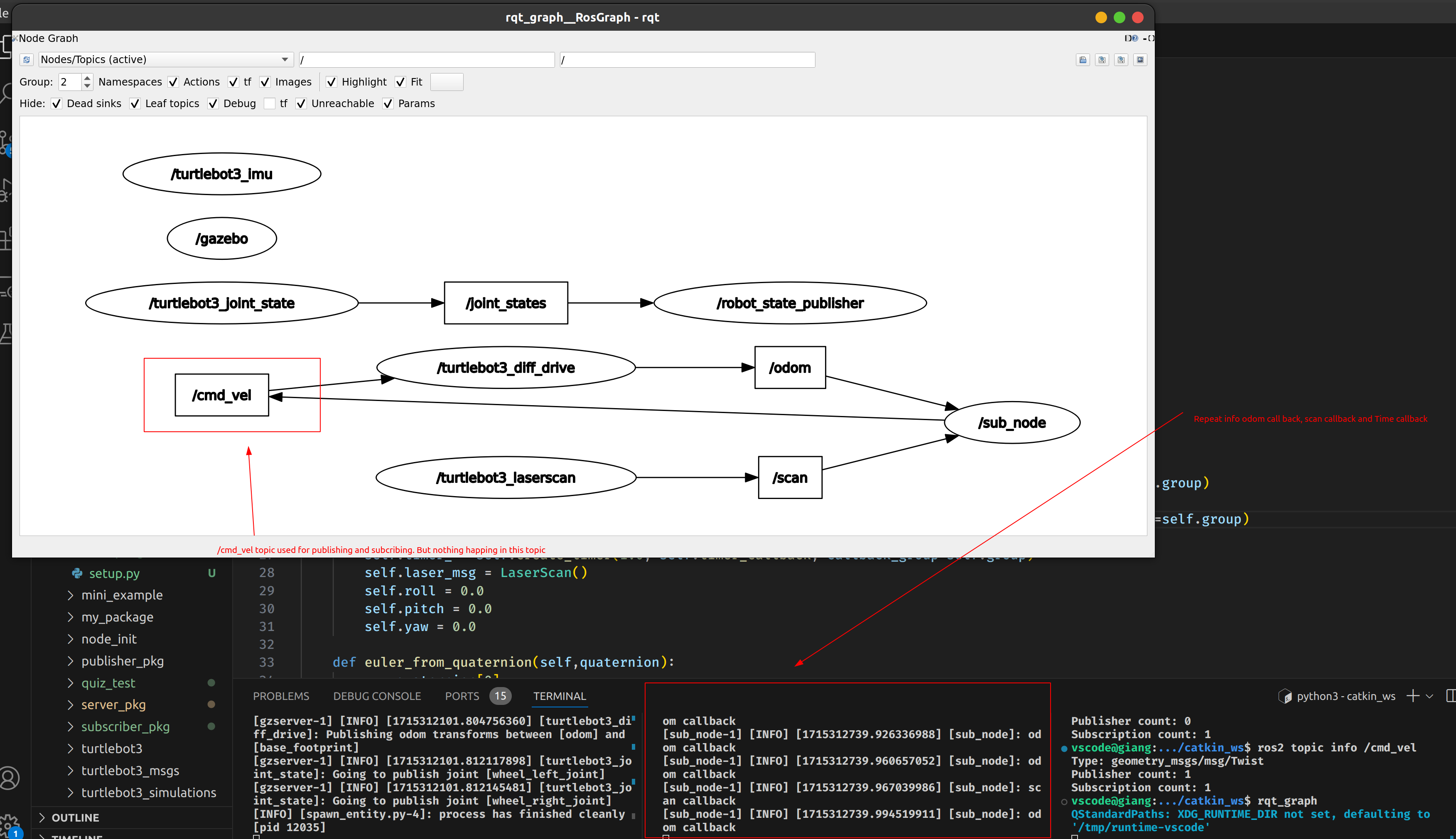

But when i ran code, robot wasn’t moving and in cmd_vel topic nothing happen
