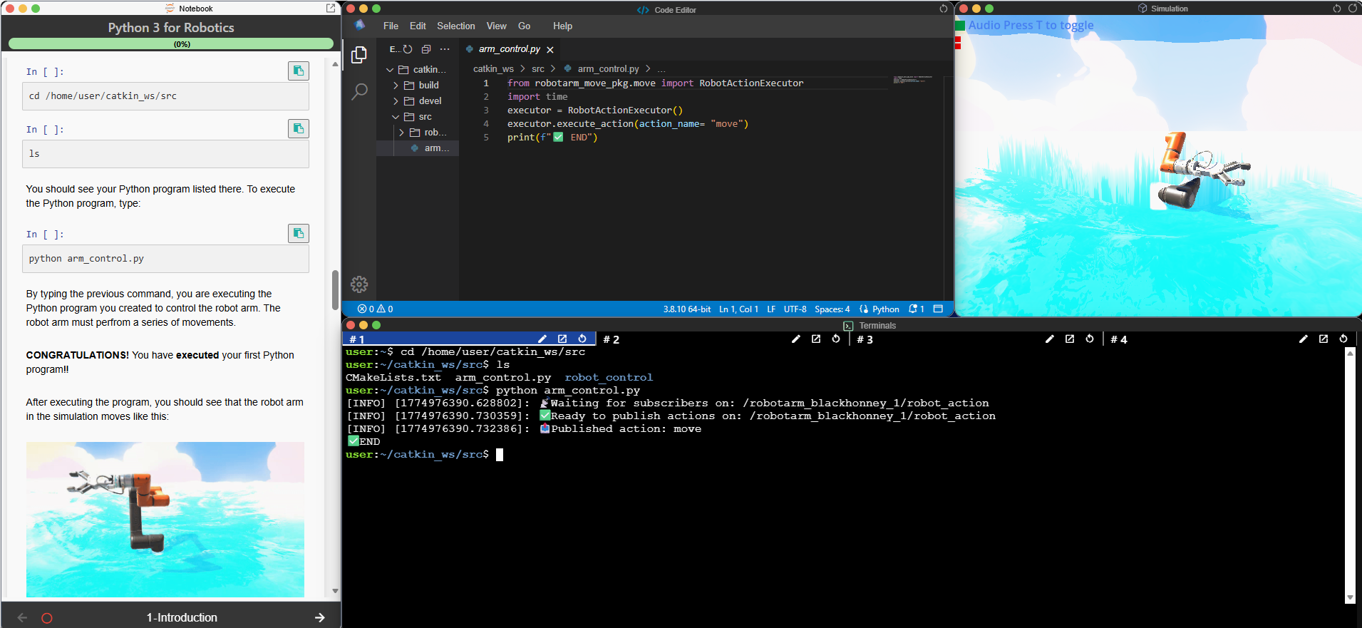

I am doing the tutorial for Python3 for Robotics and the first exercise is not excuting correctly as I copied the code the instructions provided and the exercise said that the robot black honey would move but it didnt after several attempts and tried to do the next exercise and was showing same results. Why is that?
It could be that the simulation was not loaded properly.
  • Did you notice some red dots in the top-left corner of the simulation window?
  • Can you share a picture of the whole screen with us? That helps a lot.
It was indeed the “red dots” case. Please take a look at the post below for how to solve it:
