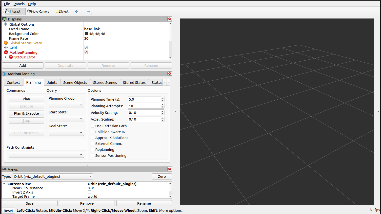

I use it on ubuntu 22.04 and ros humble. I use the ur_description package from the UR robot homepage. Then I create the moveit package from moveit_setup_assistant as the lesson. But when I run 2 launch files at the same time (move_group and moveit_rviz), my rviz does not show the robot. So what should I do with my own system?

[rviz2-1] [ERROR] [1734452268.902059852] [rviz]: Could not find parameter robot_description and did not receive robot_description via std_msgs::msg::String subscription within 10.000000 seconds.
[rviz2-1] Error: Error document empty.
[rviz2-1] at line 100 in ./urdf_parser/src/model.cpp
[rviz2-1] Failed to parse robot description using: urdf_xml_parser/URDFXMLParser
[rviz2-1] [INFO] [1734452269.009567396] [moveit_rdf_loader.rdf_loader]: Unable to parse URDF
[rviz2-1] [ERROR] [1734452269.013329334] [moveit_ros.planning_scene_monitor.planning_scene_monitor]: Robot model not loaded
My rviz result is as shown below:
I also tried with packages downloaded from construct rosject

Looking at your Terminal 2 results, I am assuming that the action server /recognize_objects is something from the course dependency files form The Construct. So naturally, it won’t be available on your personal computer, even if you copy the packages from the course onto your computer.
As for the robot not loading, you need to get the proper package for UR robots. Check if you have a ur_description package that contains all the necessary robot description files. You might have to make your MoveIt2 configuration package again using Setup Assistant on your computer. The path to packages may have changed when you copied/downloaded the UR robot files on to your computer.
Try to manually publish the robot description data into the respective robot description topic in a launch file and check if that works.
