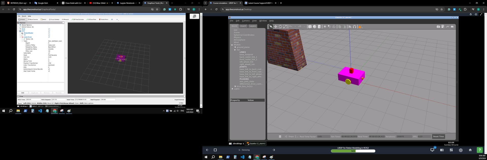

Lidar Plugin does not work well
Hi, I followed your guide to add a lidar sensor and use the lidar plugin but it does not work as same as the guide.

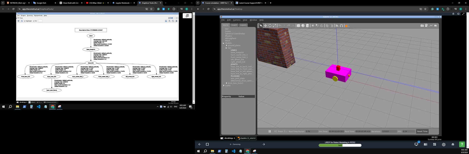

  1. Although the gazebo showed the laser_scan_link but I do not see the link, the joint in the list of link, and the joint in Gazebo Models. Why?

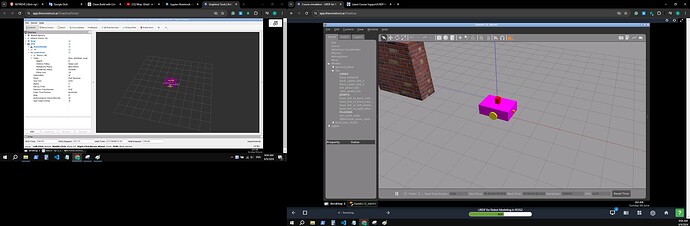

  2. I added some obstacles but the lidar data is very weird. Could you explain why?
Thanks
I send my urdf file.
