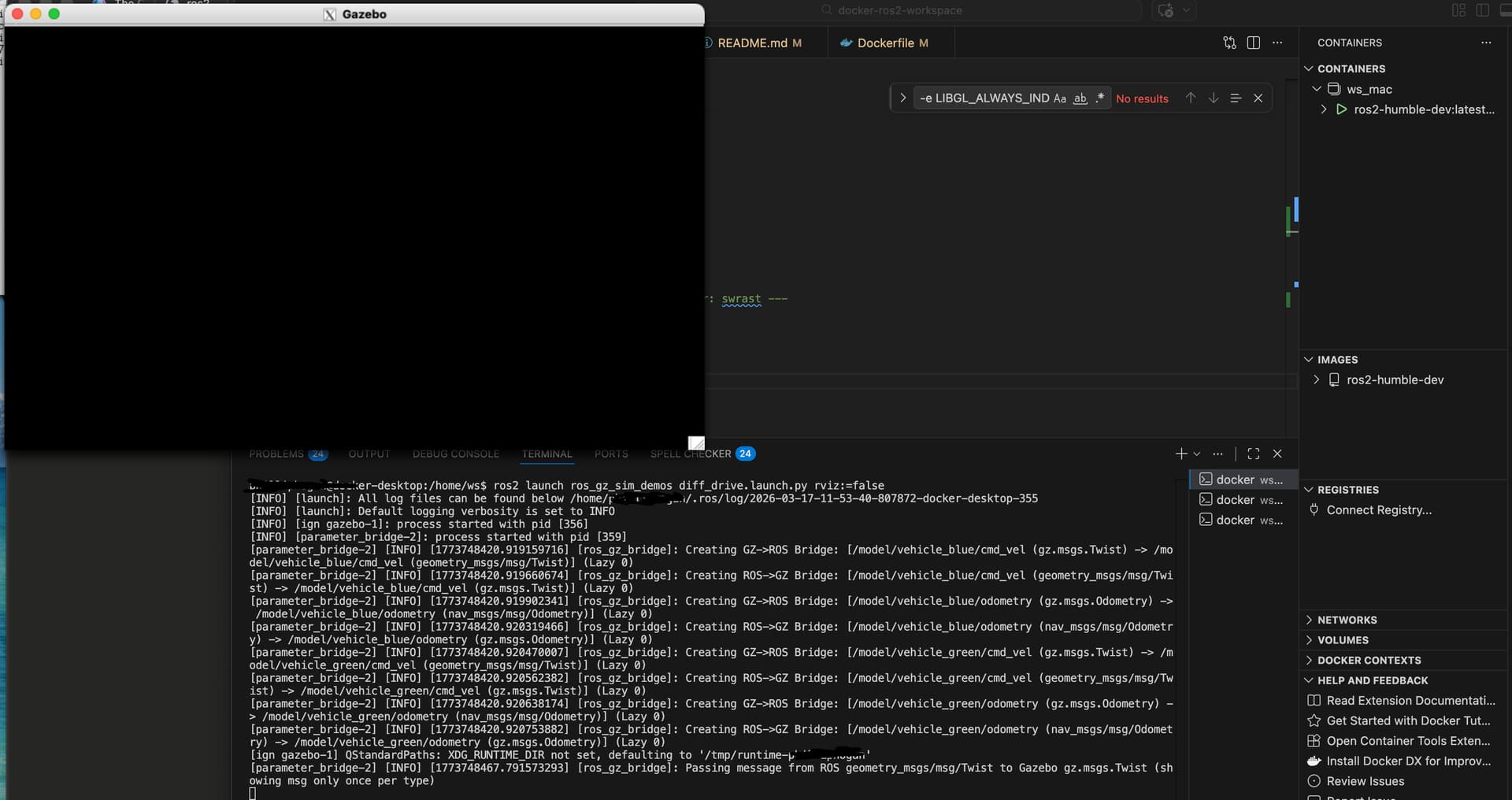

Hi @ralves,
I reset my local. I am now not getting any errors, just a blank black screen in Gazebo. I can publish to topics and see things coming through, but nothing appears in my simulation.

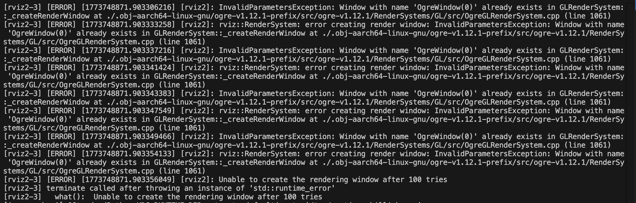

If I try and also run without the rviz = false, then I get the below errors:
Hi @phillip.jr.hogan,
The black screen suggests that somehow the graphics are not allowed in the container.
Have you executed xhost +localhost on the host to allow the containers to access the X server?
xhost +localhost
Before running the launch file that launches Gazebo, could you try to export these variables first to see if the graphics appear (I’m not expert on those vars, but every now and then we find them on the forums)?
export QT_X11_NO_MITSHM=1
export LIBGL_ALWAYS_SOFTWARE=1
Also, before launching RViz, could you try:
export OGRE_RTT_MODE=Copy
If that doesn’t work, are you mounting the /tmp/.X11-unix folder inside the container? If so, does the value of the DISPLAY variable is the same as outside the container? If not the same and you are mounting that folder inside the container, please make sure the value of DISPLAY inside the container is the same as the variable outside the container.
Please let us know how far you can get.
