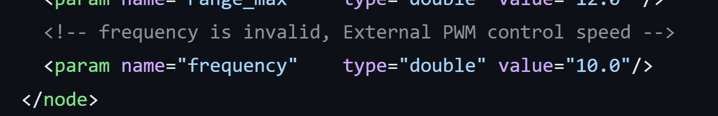

In official repository I have observed one thing in X2.launch(Iam using YDLidar X2) file
Does this line represent speed control of motor?
And official tortoisebot repo have their modified version of ydlidar SDK package where they have customized as per their requirement and I am unable to figure it out.
I don’t know if you can change it from the lidar package, it depends if the developers considered it or not.
It looks like that’s a ROS parameter from an xml launch, and yeah I mean the comment above says frequency is invalid, external pwm control speed seems like a cryptic comment, maybe it means it doesn’t work? You need to go into the cpp that is supposed to take in that parameter and see if it does it.

yeah i have tried but not in official repo, however i used tortoisebot repo and tried changing it but didnot work i have observed they have added few conditions too in ydlidar_node.cpp
I’m not sure thing might affect the speed but tried changing this too but did not work.
