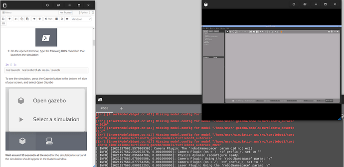

Hey, I’m unable to launch the ROSject simulation on running:
roslaunch realrobotlab main.launch
I’m sure this command worked a week or so back. I’m pretty sure I didn’t change anything on my end.
My ROS_PACKAGE_PATH also seems to be properly set:
echo $ROS_PACKAGE_PATH /home/user/catkin_ws/src:/home/user/simulation_ws/src:/home/simulations/public_sim_ws/src:/opt/ros/noetic/share
Error:
[Err] [InsertModelWidget.cc:417] Missing model.config for model "/home/user/.gazebo/models/RubberDucky"
[Err] [InsertModelWidget.cc:417] Missing model.config for model "/home/user/.gazebo/models/lms1xx"
[Err] [InsertModelWidget.cc:417] Missing model.config for model "/home/user/.gazebo/models/media"
[Err] [InsertModelWidget.cc:417] Missing model.config for model "/home/user/.gazebo/models/meshes"
[Err] [InsertModelWidget.cc:417] Missing model.config for model "/home/user/.gazebo/models/turtlebot3_autorace"
[Err] [InsertModelWidget.cc:417] Missing model.config for model "/home/user/.gazebo/models/turtlebot3_autorace_2020"
[Err] [InsertModelWidget.cc:417] Missing model.config for model "/home/user/.gazebo/models/turtlebot3_description"
[Err] [InsertModelWidget.cc:417] Missing model.config for model "/home/user/simulation_ws/src/turtlebot3/turtlebot3_simulations/turtlebot3_gazebo/models/turtlebot3_autorace"
[Err] [InsertModelWidget.cc:417] Missing model.config for model "/home/user/simulation_ws/src/turtlebot3/turtlebot3_simulations/turtlebot3_gazebo/models/turtlebot3_autorace_2020"
[ INFO] [1619354427.680170526]: Camera Plugin: The 'robotNamespace' param did not exit
[ INFO] [1619354427.686343313, 0.001000000]: Camera Plugin (ns = ) <tf_prefix_>, set to ""
[ INFO] [1619354428.349798721, 0.001000000]: Camera Plugin: Using the 'robotNamespace' param: '/'
[ INFO] [1619354428.357396056, 0.001000000]: Camera Plugin (ns = /) <tf_prefix_>, set to ""
[ INFO] [1619354428.370101207, 0.001000000]: Laser Plugin: Using the 'robotNamespace' param: '/'
[ INFO] [1619354428.371870644, 0.001000000]: Starting Laser Plugin (ns = /)
[ INFO] [1619354428.374598306, 0.001000000]: Laser Plugin (ns = /) <tf_prefix_>, set to ""
[ INFO] [1619354428.443613122, 0.001000000]: Starting plugin DiffDrive(ns = //)
[ INFO] [1619354428.443789251, 0.001000000]: DiffDrive(ns = //): <rosDebugLevel> = na
[ INFO] [1619354428.444880778, 0.001000000]: DiffDrive(ns = //): <tf_prefix> =
[ INFO] [1619354428.445984514, 0.001000000]: DiffDrive(ns = //): Advertise joint_states
[ INFO] [1619354428.447024962, 0.001000000]: DiffDrive(ns = //): Try to subscribe to cmd_vel
[ INFO] [1619354428.449670530, 0.001000000]: DiffDrive(ns = //): Subscribe to cmd_vel
[ INFO] [1619354428.450300759, 0.001000000]: DiffDrive(ns = //): Advertise odom on odom
[spawn_urdf-4] process has finished cleanly
log file: /home/user/.ros/log/6764cf90-a5c3-11eb-a8e4-0242ac1c0002/spawn_urdf-4*.log
[Wrn] [Publisher.cc:136] Queue limit reached for topic /gazebo/default/pose/local/info, deleting message. This warning is printed only once.

Yes, the simulation fails to launch @duckfrost
The terminal logs for me:
user:~$ roslaunch realrobotlab main.launch
... logging to /home/user/.ros/log/3014b2b2-af2d-11eb-a2e6-0242c0a86007/roslaunch-2_xterm-2109.log
Checking log directory for disk usage. This may take a while.
Press Ctrl-C to interrupt
Done checking log file disk usage. Usage is <1GB.
started roslaunch server http://2_xterm:45713/
SUMMARY
PARAMETERS
* /gazebo/enable_ros_network: True
* /robot_description: <?xml version="1....
* /robot_state_publisher_turtlebot3/publish_frequency: 5.0
* /rosdistro: noetic
* /rosversion: 1.15.9
* /use_sim_time: True
NODES
gazebo (gazebo_ros/gzserver)
gazebo_gui (gazebo_ros/gzclient)
robot_state_publisher_turtlebot3 (robot_state_publisher/robot_state_publisher)
spawn_urdf (gazebo_ros/spawn_model)
auto-starting new master
process[master]: started with pid [2119]
ROS_MASTER_URI=http://2_xterm:11311
setting /run_id to 3014b2b2-af2d-11eb-a2e6-0242c0a86007
process[rosout-1]: started with pid [2129]
started core service [/rosout]
process[gazebo-2]: started with pid [2136]
process[gazebo_gui-3]: started with pid [2139]
process[spawn_urdf-4]: started with pid [2144]
process[robot_state_publisher_turtlebot3-5]: started with pid [2145]
+++ ls /usr/bin/gzclient-11.1.0
++ gzclient_path=/usr/bin/gzclient-11.1.0
++ DISPLAY=:2
++ /usr/bin/gzclient-11.1.0 --verbose -g /opt/ros/noetic/lib/libgazebo_ros_paths_plugin.so -g /opt/ros/noetic/lib/libgazebo_ros_api_plugin.so __name:=gazebo_gui __log:=/home/user/.ros/log/3014b2b2-af2d-11eb-a2e6-0242c0a86007/gazebo_gui-3.log
Gazebo multi-robot simulator, version 11.1.0
Copyright (C) 2012 Open Source Robotics Foundation.
Released under the Apache 2 License.
http://gazebosim.org
[Wrn] [GuiIface.cc:199] g/gui-plugin is really loading a SystemPlugin. To load a GUI plugin please use --gui-client-plugin
[ INFO] [1620389420.569162899]: Finished loading Gazebo ROS API Plugin.
[ INFO] [1620389420.572288508]: waitForService: Service [/gazebo/set_physics_properties] has not been advertised, waiting...
[Msg] Waiting for master.
[Msg] Connected to gazebo master @ http://127.0.0.1:11345
[Msg] Publicized address: 192.168.96.7
Warning [parser.cc:723] Can not find the XML attribute 'version' in sdf XML tag for model: ring_road_v2. Please specifythe SDF protocol supported in the model configuration file. The first sdf tag in the config file will be used
[ INFO] [1620389420.894498326]: Finished loading Gazebo ROS API Plugin.
[ INFO] [1620389420.897826476]: waitForService: Service [/gazebo_gui/set_physics_properties] has not been advertised, waiting...
Warning [parser.cc:723] Can not find the XML attribute 'version' in sdf XML tag for model: triangular_prism_direccion_obligada. Please specify the SDF protocol supported in the model configuration file. The first sdf tag in the config filewill be used
Warning [parser.cc:723] Can not find the XML attribute 'version' in sdf XML tag for model: triangular_prism. Please specify the SDF protocol supported in the model configuration file. The first sdf tag in the config file will be used
[Wrn] [GuiIface.cc:119] QStandardPaths: XDG_RUNTIME_DIR not set, defaulting to '/tmp/runtime-user'
Warning [parser.cc:723] Can not find the XML attribute 'version' in sdf XML tag for model: triangular_prism_pedestrian.Please specify the SDF protocol supported in the model configuration file. The first sdf tag in the config file will beused
Warning [parser.cc:723] Can not find the XML attribute 'version' in sdf XML tag for model: OverLoard Camera. Please specify the SDF protocol supported in the model configuration file. The first sdf tag in the config file will be used
[ INFO] [1620389421.487788540]: waitForService: Service [/gazebo/set_physics_properties] is now available.
[ INFO] [1620389421.525095004]: Physics dynamic reconfigure ready.
[ INFO] [1620389422.287830431]: Camera Plugin: The 'robotNamespace' param did not exit
[ INFO] [1620389422.294296210, 0.001000000]: Camera Plugin (ns = ) <tf_prefix_>, set to ""
[ INFO] [1620389422.957793089, 0.001000000]: Camera Plugin: Using the 'robotNamespace' param: '/'
[ INFO] [1620389422.961517528, 0.001000000]: Camera Plugin (ns = /) <tf_prefix_>, set to ""
[ INFO] [1620389422.978066502, 0.001000000]: Laser Plugin: Using the 'robotNamespace' param: '/'
[ INFO] [1620389422.978310757, 0.001000000]: Starting Laser Plugin (ns = /)
[ INFO] [1620389422.991079277, 0.001000000]: Laser Plugin (ns = /) <tf_prefix_>, set to ""
[ INFO] [1620389423.047533832, 0.001000000]: Starting plugin DiffDrive(ns = //)
[ INFO] [1620389423.047995840, 0.001000000]: DiffDrive(ns = //): <rosDebugLevel> = na
[ INFO] [1620389423.048959681, 0.001000000]: DiffDrive(ns = //): <tf_prefix> =
[ INFO] [1620389423.050246528, 0.001000000]: DiffDrive(ns = //): Advertise joint_states
[ INFO] [1620389423.050991343, 0.001000000]: DiffDrive(ns = //): Try to subscribe to cmd_vel
[ INFO] [1620389423.054036400, 0.001000000]: DiffDrive(ns = //): Subscribe to cmd_vel
[ INFO] [1620389423.054713824, 0.001000000]: DiffDrive(ns = //): Advertise odom on odom
log file: /home/user/.ros/log/3014b2b2-af2d-11eb-a2e6-0242c0a86007/spawn_urdf-4*.log
and the gazebo window shows Gazebo open but no sim running.

Hey, I tried deleting and then re-cloning the ROSject, still doesn’t work. I can’t share my ROSject, it complains “You can not share a fork whose parent is private”
Here’s a screenshot. The namespace errors are new after re-forking.
Its working, just that the camera is zoomed in. I you zoom out in Gazebo you should see the turtlebot and all the simulation. Try that if not then download through teh IDE the simulations_ws and share it here so I can have a look.
Thanks a ton, that was it, Just zoomed out and saw the entire playing field. Thanks a lot for being patient!
