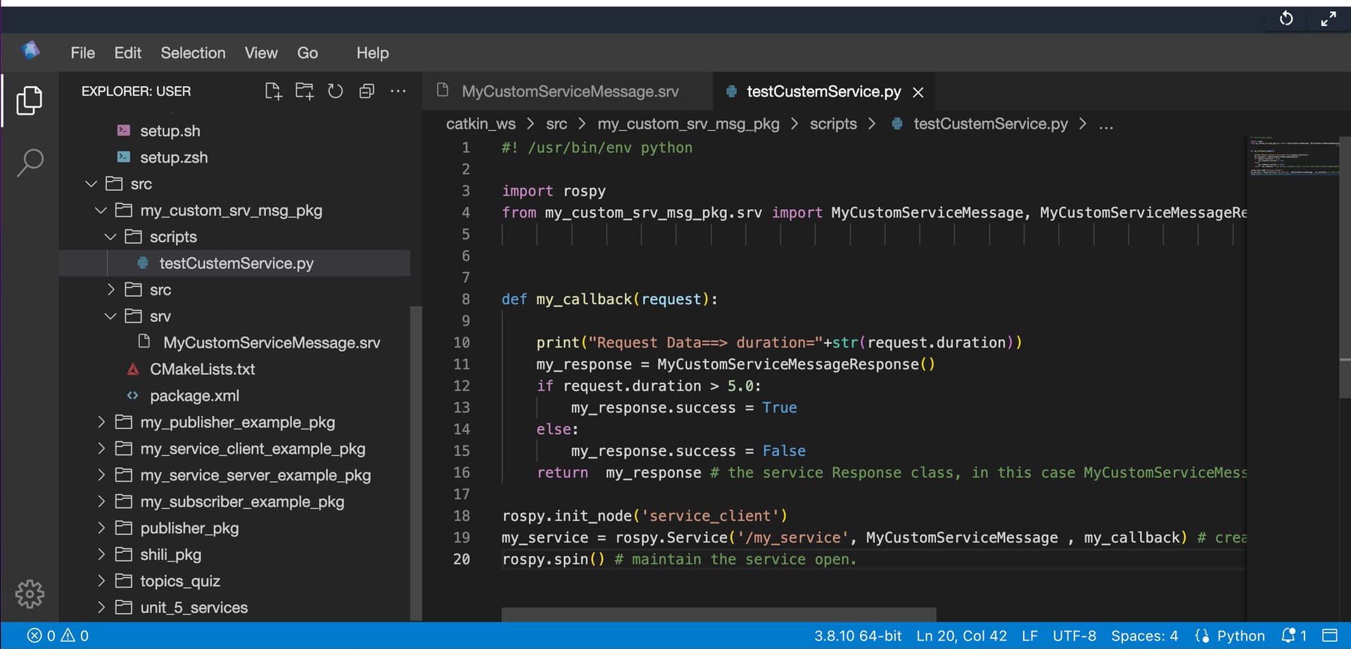

I followed the whole instruction of lesson “6.4 Custom Service Messages” but when I did catkin_make I didn’t see this line: Generating Python code from SRV my_custom_srv_msg_pkg/MyCustomServiceMessage
But I see the created service among the rossrv list: my_custom_srv_msg_pkg/MyCustomServiceMessage
Furthermore, when I create Service Server that uses this type of message and try to run it with this command:
rosrun my_custom_srv_msg_pkg testCustemService.py
I will receive this error:
Traceback (most recent call last):
File “/home/user/catkin_ws/src/my_custom_srv_msg_pkg/scripts/testCustemService.py”, line 4, in
from my_custom_srv_msg_pkg.srv import MyCustomServiceMessage, MyCustomServiceMessageResponse # you import the service message python classes
ModuleNotFoundError: No module named ‘my_custom_srv_msg_pkg’
