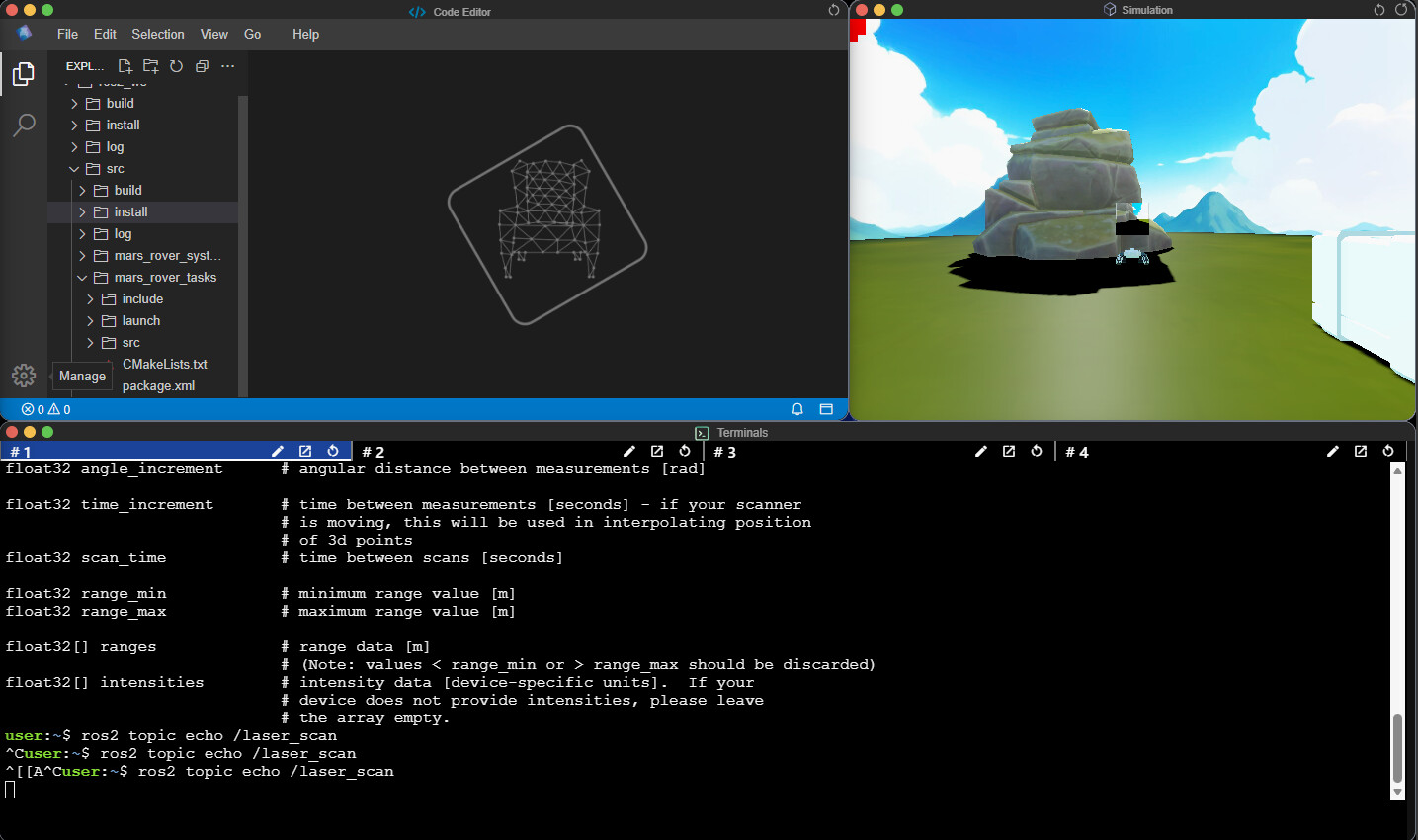

Hi, the issue appeared suddenly overnight, the simulation stops to respond to the keyboard comands and if i echo the topics nothing is published.
not sure what it means, but on the top-left corner of simulation there are red square dots that before were green.

i tried to open the simulation on firefox and to use a different network but that didn’t resolve, i disable the extension and clean the cache but didn’t work niether,
but i resolved the issue by closing nordvpn app, it wasn’t connected but for some reason it interfered with the browser even if disconnected, probably is due to threat protection.
thanks for the help, hope my solution can help
